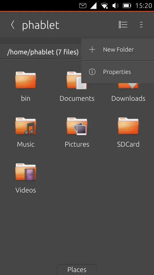

A comment before recommended linking your SDCard from your home directory. This is how it goes.
  1. SSH into your phone or open the terminal app. Stay in your home folder.
  2. Find the mountpoint of your SD-Card: ls /media/phablet/. In my case AC5D-91D7
  3. Create a symbolic link. You have to replace AC5D-91D7 with the output of the command in step 2: ln -s /media/phablet/AC5D-91D7 SDCard
Now you can simply click on the SDCard folder in the File Manager App to see the contents of your SDCard.
Additional:
In case you want to keep your files on your SDCard rather than the internal storage you may consider (example for Music):
    rmdir Music
    ln -s /media/phablet/AC5D-91D7/Music Music
Your Music Folder is now located on the SDCard.
SDCard accessible as a symbolic link and Music and Video replaced by symbolic links to the corresponding folders on the SDCard
