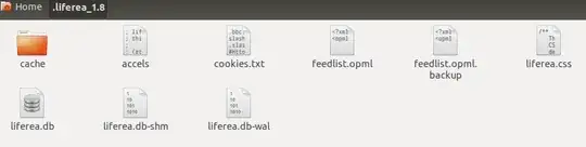

On which folder(s) Liferea stores user data (subscriptions and articles)? There is a folder named .liferea_1.8 in my home but it does not contain any user data.
The goal is to synchronise that folder with a cloud service so that Liferea accesses the exact same assets at home, work, etc.
Note: the official Liferea support medium, a mailling list, seems to have been deactivated last April.

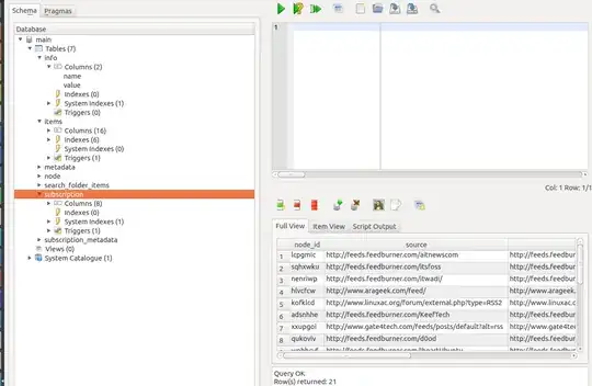

configuration files mainly founded under ~/.gconf/apps/liferea While other files such as user data and subscriptions,etc... are founded in a SQLite3 database named liferea.db under ~/.liferea_1.8 directory.
If you open that db you can find the data inside:
