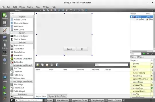

In the library packed are no binaries for the designer application.
Install the designer with
sudo apt-get install qtcreator
