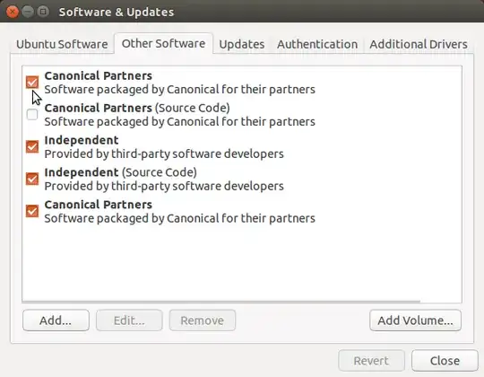

    To install flash player in Chromium web browser search the Dash for Software & Updates and open the Software & Updates window. Click the Other Software tab in the Software & Updates window and put a check mark in the checkbox to the left of where it says: Canonical Partners.
    Click the Close button to close the Software & Updates window.
