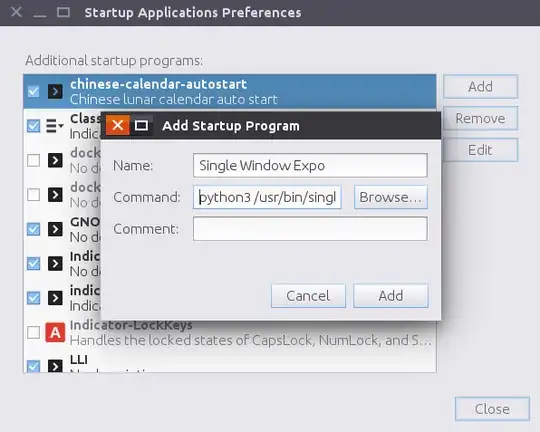

This is meant to be saved as /usr/bin/single_click_expo.py file and added to Startup Applications
