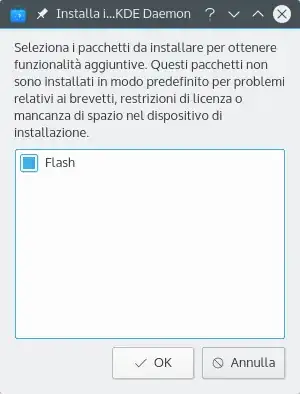

Whenever I login I can see an item in my notification bar that asks to install other packages to make flash work. This is what comes out when clicking it:
Image of request to install packages for flash plugin

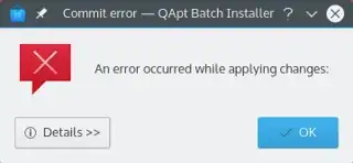

I press OK and then I insert my password to run the installation and it fails:
A dialog stating that an error occurred.
If I try to click on Details>> nothing happens.
Since the first time that this thing happened I get warnings when using flash on firefox (it says that the plugin is obsolete or something like that).
How can I fix this? Is there a way to run the above step from the command line and check what's going on and the cause of the error?
