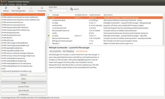

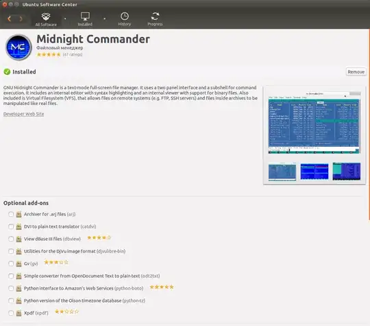

Using GUI you can open "Ubuntu Software Center" and search for mc or Midnight Commander.
It will give you full description of the package. It is also useful, if you do not know exact package name.
Also you can install Synaptic and do a similar search there.
Software can be installed in Software Center or Synaptic as well without using command line.
