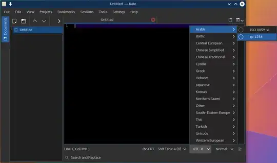

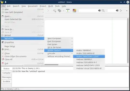

If you don't want to convert it as mentioned in Rmano's answer, you may use Geany or Kate to read/edit them ar they are, default Arabic encoding in Windows is CP-1256 (WINDOWS-1256). Just keep in mind that switching to UTF-8 is recommended over all. It is supported by Notepad++ and Windows default note editor.
Geany
sudo apt-get install geany
geany encoding
Kate
sudo apt-get install kate
kate encoding
