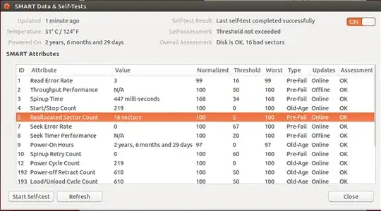

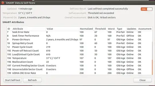

SMART Data & Self-Tests Overall Assessment reports for both disks Disk is OK. What does this mean? According to the following two screenshots is my hard disk doomed?

But your hard disk looks like it's got a pretty healthy life ahead of it. Especially look at the last column: Assessment is OK everywhere!
Interpreting all of your data is going to be too broad to answer here. For more information on SMART technology, have a look at this excellent Q&A.
On the 5 bad sectors: the time that a hard disk was manufactured without any bad sectors is long gone: nowadays they have a number of spare sectors which are swapped out automatically without you even noticing. So yours has 5% of its spare sectors allocated already, which isn't a big deal. Mine has 140 sectors out of 200 allocated and I'm not worried (yet)... ;-)
Which means you still have to run back-ups! (there are other ways to lose data then a failed hard disk)

I doubt it is a problem. In general I would expect the Assessment column to show something else than "ok".
Besides that the general conclusion in the images is "Disk is OK, 16 bad sectors".
