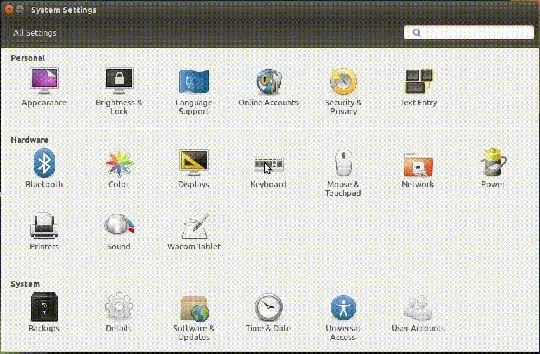

If you want to set it suing GUI :
Enable compose key by going to System Settings --> Keyboard --> Typing --> Right Alt. (you can chose a different key if you wish)
Thats all !!

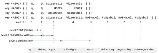

English (Dvorak, international with dead keys) - dvorak-intl works fine!
I can type Ä using ShiftAltGrq with default setup. See file /usr/share/X11/xkb/symbols/us where the q key declared as
key <AB02> { [ q, Q, adiaeresis, Adiaeresis ] };
and with level3(ralt_switch) at the bottom to use Right Alt/AltGr as 3rd level shift such that
  • 1st column qq
  • 2nd column QShiftq
  • 3rd column äAltGrq
  • 4th column ÄShiftAltGrq

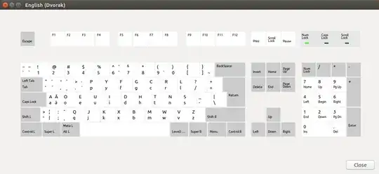

Visualization
X11 XKB layout levels
  • dvorak-intl defines only 4 levels, I draw the all 8 levels as XKB supports so you can get general overview.
  • Shift is a standard level2 shift, AltGr is the default level3 shift for most layouts which need level3&4. Only few layouts define levels5,6,7,8 and so the level5 shift key, I used RCtrl just for explaination.
  • All those 4 lines which define <AB02> key are equivalent.

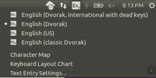

Setting ä & Ä at 3rd &4th level of a key on English (Dvorak) - dvorak layout
Plus ö & Ö ato key. (It doesn't appear in screen-shot, as it was added after screen-shot)
Same as dvorak-intl, we can make same setup for dvorak.

  3. Modify a map
    $ sudo vim /usr/share/X11/xkb/symbols/us +224
    key <AD11> { [      slash,  question        ]       };
    key <AD12> { [      equal,  plus            ]       };
    key <AC01> { [          a,  A, adiaeresis, Adiaeresis ]       };
    key <AC02> { [          o,  O, odiaeresis, Odiaeresis ]       };
    key <AC03> { [          e,  E               ]       };
  4. Setting Right Alt as level3 shift
    $ sudo vim /usr/share/X11/xkb/symbols/us +248
        key <AB09> { [          v,  V               ]       };
        key <AB10> { [          z,  Z               ]       };
        key <BKSL> { [  backslash,  bar             ]       };
        include "level3(ralt_switch)"
    // Dvorak international with dead keys
    There are many keys that can be used as ISO_Level3_Shift. Check available options
    $ more /usr/share/X11/xkb/rules/xorg.lst | grep lv3:
      lv3:switch           Right Ctrl
      lv3:menu_switch      Menu
      lv3:win_switch       Any Win key
      lv3:lwin_switch      Left Win
      lv3:rwin_switch      Right Win
      lv3:alt_switch       Any Alt key
      lv3:lalt_switch      Left Alt
      lv3:ralt_switch      Right Alt
      lv3:ralt_switch_multikey Right Alt, Shift+Right Alt key is Compose
      lv3:ralt_alt         Right Alt key never chooses 3rd level
      lv3:enter_switch     Enter on keypad
      lv3:caps_switch      Caps Lock
      lv3:bksl_switch      Backslash
      lv3:lsgt_switch      &lt;Less/Greater&gt;
      lv3:caps_switch_latch Caps Lock chooses 3rd level, acts as onetime lock when pressed together with another 3rd-level-chooser
      lv3:bksl_switch_latch Backslash chooses 3rd level, acts as onetime lock when pressed together with another 3rd-level-chooser
      lv3:lsgt_switch_latch &lt;Less/Greater&gt; chooses 3rd level, acts as onetime lock when pressed together with another 3rd-level-chooser
    For example, if you like to use Caps Lock as the level3 shift then enter include "level3(caps_switch)" instead of include "level3(ralt_switch)".
  5. Force reload of layouts
    sudo dpkg-reconfigure xkb-data
    Change to another layout then back.
  6. Check point
    • Verify the current map of dvorak
      English (Dvorak)
    • Verify Right Alt mapping. It should be ISO_Level3_Shift
