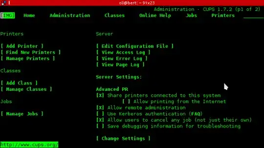

  • Use a command line browser over SSH. Not the prettiest but quick and functional.
    links http://localhost:631/

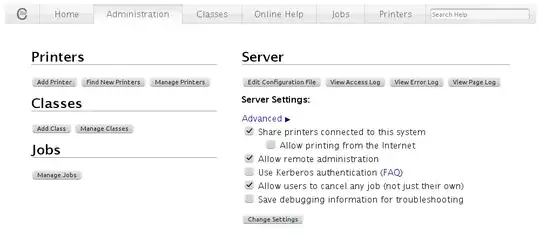

    It's very similar to the interface in a graphical browser. Just compare it yourself.
