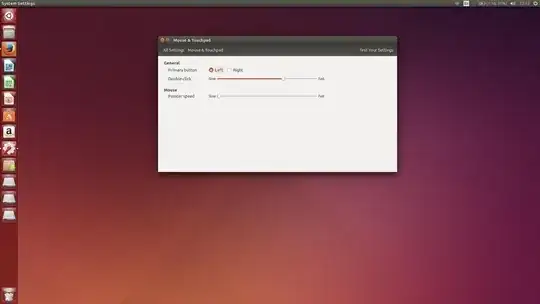

I use Ubuntu 14.04 LTS and for some reason I can't scroll with 2 fingers.
I don't have an option to add it in settings:
Settings dialog
