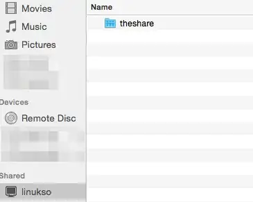

So I see the PC in the network, and I see the share: You can see the share

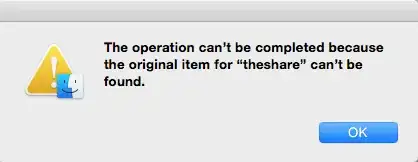

But when I try to click on the folder, Finder crashes and I get this error: Finder error message
Any ideas?
