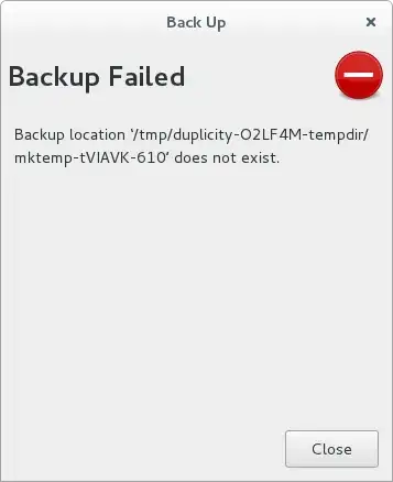

Try with the Backups (Deja Dup) software
I did start the backup first time but I wanted to go to lunch after backup was running already two hours of just 10 GB files. So it gave me this after the lunch
which is really insane, reported now here, since the software is not designed to have pauses in doing the backups.
