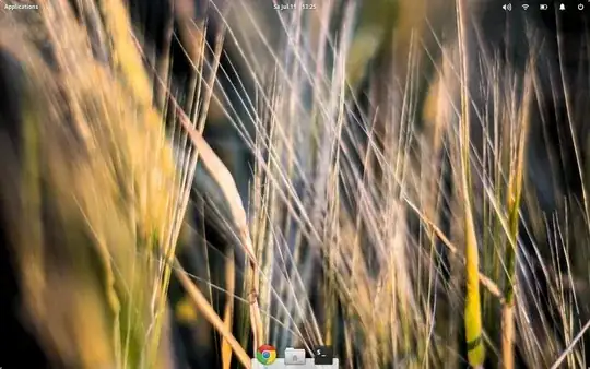

In the all the far corners of my screen, I am seeing weird, glitchy dots/errors, in squares of about 2x2 pixels. I am on the most recent version of elementary OS with an nvidia GeForce 9300m and the proprietary nvidia driver version 340.76 (which is the last one supporting my graphics card). I need to keep the proprietary driver for opencl support.
How can I fix these dots? See these screenshots: enter image description here enter image description here

Appearently this is an issue with my graphics card and the slightly rounded corners of the elementary interface. There is a bug report here: https://bugs.launchpad.net/elementaryos/+bug/1437468 And a workaround has been proposed here: http://www.reddit.com/r/elementaryos/comments/3aj5hi/there_will_be_4_white_dots_at_corner_after_i_wake/ This won't fix the glitch, but it will disable the rounded corners.

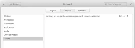

gsettings set org.pantheon.desktop.gala.mask-corners enable true
I made a custom shortcut to run this command.
