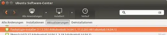

Edit: Flash version numbers don't match
I just noticed that the plugin page in Firefox told me that the version I had installed was vulnerable though I had the latest version of the of flashplugin-installer installed and it matched with the version number of the plugin for Linux on Adobe's site.
However what I must have ignored: the version number for Flash in Firefox was lower!
After running sudo apt-get install --reinstall flashplugin-installer it re-downloaded Adobe Flash and all version numbers matched up without restarting Firefox.
You should be able to find an entry in your USC history or the apt log when the package was updated the last time. Just run the update-manager from the dash to search for new packages and install them.
