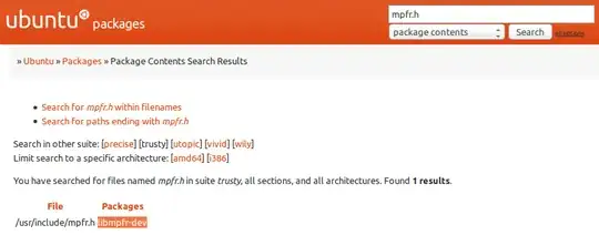

For example to find which package to install to get mpfr and /usr/include/mpfr.h, use the package contents search engine on packages.ubuntu.com
You'll immediately know which package to install, here sudo apt-get install libmpfr-dev:
In order to jhbuild build, most of the packages you'll have to install are packages ending with -dev, containing the missing header files. So it will be libespeak-dev instead of just espeak.
