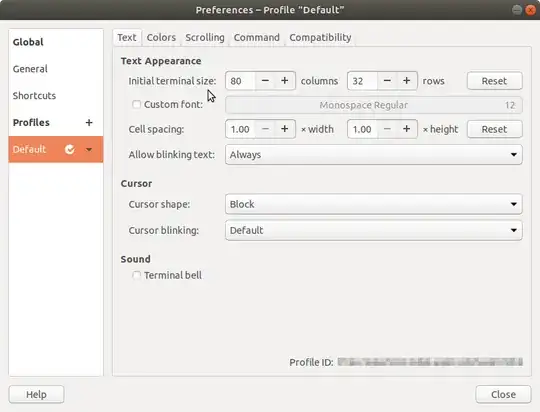

In Ubuntu 17.10 and later open the terminal, select Edit->Preferences -> Default profile -> Text tab and change the values for columns and rows after where it says Initial terminal size:.
IMG:
  17.10 and later
