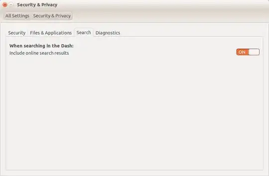

I don't like getting online results when searching in my dashboard, so I went to System Settings > Security & Privacy > Search, and I turned the setting off:
Online search results setting off
But when I restart my machine, the setting is always reset to:
Online search results setting on
So how can I permanently disable it without it turning on again after a restart?

You can switch off online search results with the command:
gsettings set com.canonical.Unity.Lenses remote-content-search 'none'
To make the command run on startup, and make sure it is set after a restart, add the following to your startup applications:
