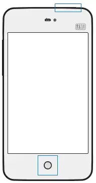

According to the Manual of the phone on page 18 you have to press the Power and Home buttons simultaneously,
Meizu MX4 buttons
then go to SettingsUser dataFactory reset and check the Clear Data Simultaneously check box during the eventual firmware update.
And that should clear all settings. If that doesn't solve your problem, press the Power and Home buttons simultaneously for 10 seconds and that should then completely reset your phone.
