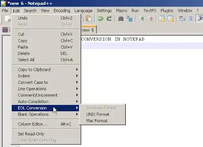

On Windows, you need to change the End of Line (EOL) format in Notepad++ to UNIX:
That way it will work on Ubuntu too.
