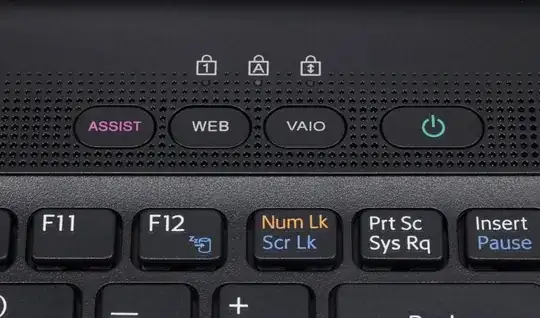

To boot a Sony VAIO from a USB stick you need to:
  1. Shut down Windows.
  2. Insert an Ubuntu LiveUSB
  3. Turn the laptop on using the "ASSIST" button (not the power button).
  1. Select boot from external drive.
Then follow Ubuntu installation manuals.
