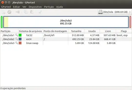

My problem is that when attempting to resize the dev / sda2, both the minimum and the maximum size, are of the same value (which is the disk size: 708 862 MB).
What should I do?
What should I do?
You can not resize partitions because they are locked.
You need to boot from Ubuntu LiveUSB to do it.
It is impossible to resize Ubuntu partitions from inside a working system.
You can't use the active OS to alter the media that hosts the active OS. It's like you doing brain surgery on yourself. You need to boot to an OS hosted on different media. A live-booting version of Ubuntu on a USB flash drive would be excellent, but back up everything you don't want to lose first!
