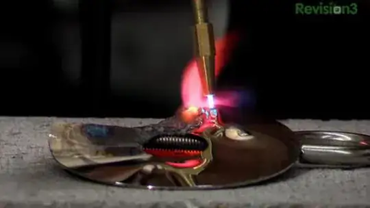

This doesn't really answer your question, as you want to use the HDD. However, it's important.
If this is really important data that should never be recovered, it's not safe to use the disk any more. Apple Macs offer a 35 overwrite feature - which they claim is what the government requires, but it's complicated:
Effective immediately, DSS will no longer approve overwriting procedures for the sanitization or downgrading (e.g. release to lower level classified information controls) of IS storage devices (e.g., hard drives) used for classified processing.
It is thought that some of the 3-letter agencies (FBI, CIA, MI6) require physical destruction of magnetic media (e.g., melting in a furnace).
You do have a few options - the one I've relied on in the past is hitting it with a hammer lots of times, then wiping the magnets over it.
However, I'm a student and nobody wants to hack into an empty bank account, so it didn't need to be as secure. Plus, I wasn't going to bin the Hard Drive - it's now a bird scarer for the allotment.
If you work under confidentially agreements (especially those involving the government) you need something a little more secure. I'd recommend a blowtorch:
Source, CNET
