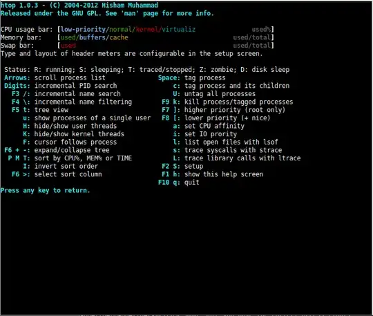

TL;DR The standard way to quit htop is F10 or q.
Therefore if you can't use F10, use q (lowercase).

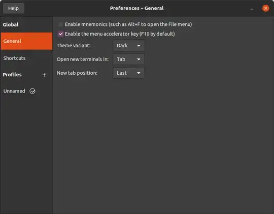

If you are using gnome-terminal, yes, you can disable that the F10 key opens the menu:
Open gnome-terminal's menu with F10 or with the mouse and go to Preferences. In the General section and disable the Enable the menu accelerator key (F10 by default) option.
