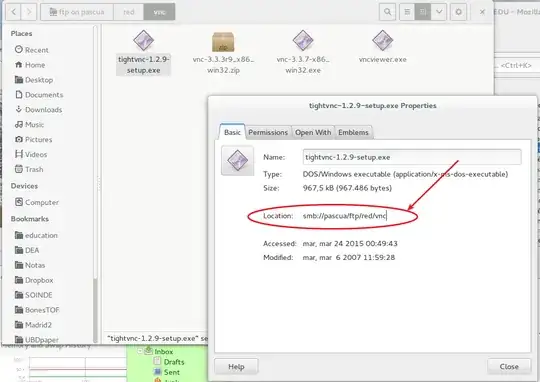

If you can navigate to your file, you can see what the path (URL) is. If you are accessing the file with your browser, the one that (should) work with a browser is available in the properties dialog of the file manager (right click on the object):
property window

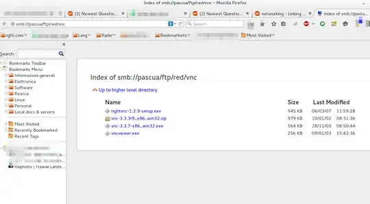

and it works for me:
samba share in firefox
The complete path to my file would be smb://pascua/ftp/red/vnc/tightvnc-1.2.9-setup.exe and if it where an image, feeding it to the browser will show it.

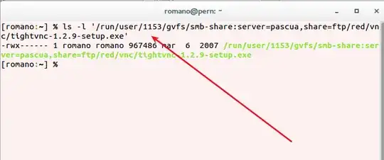

Additionally, the file from a remote server is visible somewhere in your directory hierarchy, and accessible as a normal file. To know how the file is known in the file system (as if it where a local file), drag the file icon in a terminal emulator window (here I typed ls -l before):
local path to a remote file
In this case the path is strange because the file is mounted by the gvfs backend (it's a user mount), in the case of system-mounted shares it should be easier to parse.
