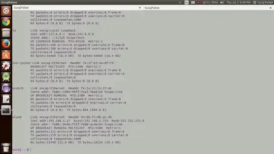

ifconfig -a
image to the output
When I ping 192.168.1.1 it gives
Destination  host unreachable
Also when I log into netgear router from another pc sometimes does not list my laptop connected to the router but what my laptop shows is it is connected to the router.Since it shows the dialog box and contents are connected to wifi name

Failure to ping google.com by name only indicates a DNS problem. Failure to ping by address indicates a connection problem. If I traceroute to google.com I get an address of 216.58.216.238 (likely one of many servers in the farm - the readers traceroute will vary).
If you can't ping google.com but can ping 216.58.216.238 you have an issue with DNS which you can likely resolve by changing the DNS server config in your router (assuming DHCP configuration for your client. Make these changes in the client configuration instead if using static IP addressing) Google public DNS server is at 8.8.8.8 as I recall your ISP can provide you with their DNS server address(es).
Being unable to ping 192.168.1.1 indicates that you may not be using the correct address as configured in the Netgear router. This address can be changed in the router configuration which can be reset to factory defaults if it's been mucked up beyond your ability to fix. It's also possible to disable wireless configuraton of the router. Use a Ethernet cable rather than wifi to access the router after restoring to default settings and set it up properly from scratch.
NOTE: Make sure you know the security type (encryption level) in use before resetting as well as the wireless passcode or you'll end up having to reconfigure every client on the network (good practice perhaps, but avoidable with a bit of pre-planning in most cases)

doubt netgear has something to do with it. i use netgear router and it works just fine with ubuntu, but i have a different wireless card.
try checking additional drivers in dash menu, if you can use other driver for your wi-fi - try it.
also try checking is your IP4 address currently used by a windows machine within same network, i saw some problems with embedded in wi-fi DHCP`s when there are different OS computers in same network.
another thing you can try is installing different software on your wi-fi router, like DD-WRT or Tomato.
Hope it helps.
