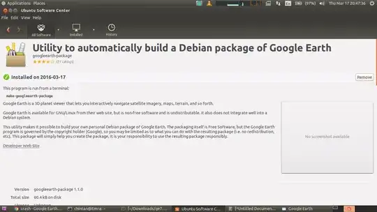

Here is a screenshot of a utility available on Ubuntu Software Cente: Debian package of Google Earth image
Steps: 1. Open Ubuntu software center and search for "googleearth" (no spaces found what I was looking for, with a space between google and earth it yielded something else).
  1. After that's the software center should look like the image I've posted. Then on your console/terminal run make-googleearth-package.
  2. Then run sudo dpkg -i googleearth_6.0.3.2197+1.1.0-1_amd64.deb as the console asks you the same after step 1 is done.
  3. If some dependencies are unmet run sudo apt-get update then run sudo apt-get -f install
  4. After step 3 run sudo dpkg -i googleearth_6.0.3.2197+1.1.0-1_amd64.deb.
This did the trick, no crashes.
