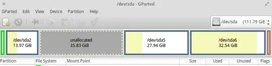

I want to resize the /dev/sda6 to ~50GB. But I can't do this, because the unallocated space is on the wrong position.
How can I move the unallocated space to the right and resize the sda6 partition?

Firstly, if you are running Gparted from a installed Ubuntu, you can't resize the partitions on which it is installed (it can unmount other partitions though), so you need to use a live disk (explained here).
Then you can resize the partitions - one way to do it is to:
  1. Move sda5 to the left (right click and use 'Resize/Move'), so there is unallocated space between sda5 and sda6: visualization1
  2. Then you can move sda6 to the left, so the unallocated space is too the right of it: visualization2
  3. Finally, you can expand sda6 so it fills the space: visualization3
The yellow parts in the GParted visualization represent the data in the partitions - all the data in the partition has to be copied bit by bit when the partition is moved, so it could take a few hours (or even days...), particularly with slower hardware. Corruption of data is possible - if it is paused or interrupted whilst formatting/copying it is almost certain, so ensure the computer is connected to a reliable power supply and not used much (to maximise the resources available - make sure it doesn't suspend etc though). Also, if the partition is a boot partition, the computer may not boot afterwards if the bit with the boot stuff has been damaged, which I think is vaguely possible even with a successful copy.
