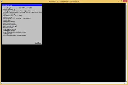

I can make a remote connection and see the xrdp login window. I chose sesman-Xvnc Module and login with my credentials.
Then see this window: XRDP-loggin-details-window

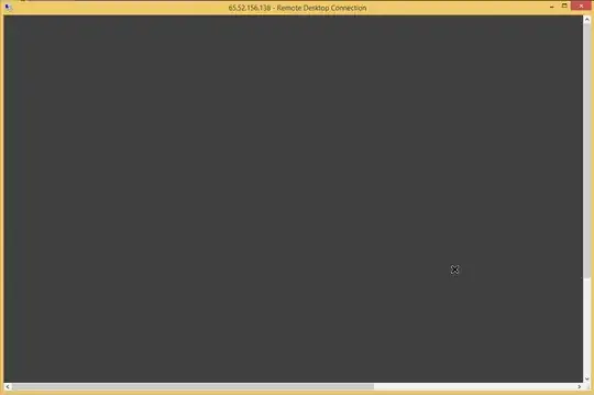

And then an empty gray window with a cursor: enter image description here
After in a few seconds my connection is lost with no message or something. What could be the reason?

possibly an old post but this might be helpful to other.
Unity Desktop is not supported by xRDP software package on Ubuntu You have to install an alternative desktop interface. A good alternative is the mate-desktop
You can install the mate-desktop using the following command
sudo apt-get install mate-core mate-desktop-environment mate-notification-daemon
Then you can install your xrdp package
sudo apt-get install xrdp
Note : On Azure, you will need to create the endpoint in order to access your Ubuntu VM using the xrdp software on the port 3389
