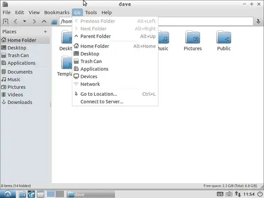

In the main menu, select Go > Connect to Server...

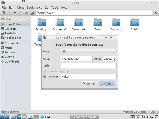

I'm not familiar with WinSCP, but I assume it uses SSH. To mount an SSH share, select SSH and fill in the appropriate information, including at least the host, port (if other than 22), and user.

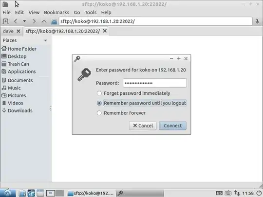

Enter your password and how long you'd like to remain connected:
Enter password & timeout
And you're in! You can browse your files, and open/delete/edit/move them (assuming you have appropriate permissions), all within PCManFM.

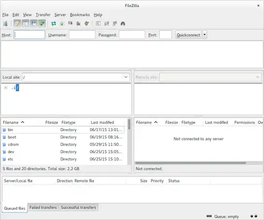

If you need a SCP client with a GUI, than you could try filezilla:
sudo apt-get install filezilla
Use sftp as protocol (eg: sftp://myhost) in the Host field as Port 22
