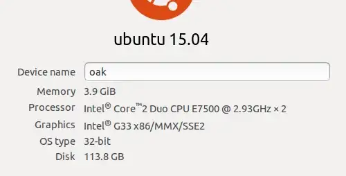

System Info:
System Information

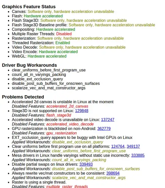

Contents of chrome://gpu
I also had same issue. Try disabling 'Use hardware acceleration when available' option in settings. Hope it helps.
I did not test this on Ubuntu yet but in windows the solution was:
  1. go to chrome://flags/
  2. go to Hardware-accelerated video decode Mac, Windows, Chrome OS
    Hardware-accelerated video decode where available
    disable-accelerated-video-decode Enable
    make it disabled .
