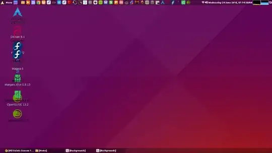

I rebooted my PC after attempting MiHa's answer and my background was the one I had wanted and then two system error messages appeared, leaving me with this desktop: enter image description here
Notice how my desktop icons are doubled up. My unwanted background before I rebooted was:
