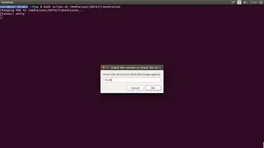

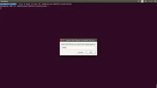

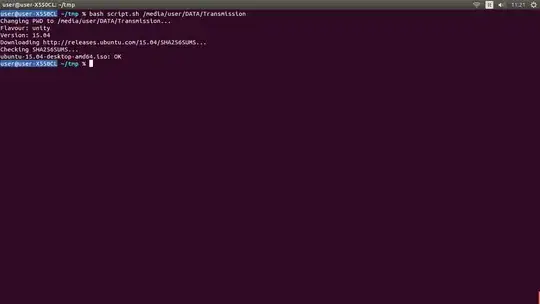

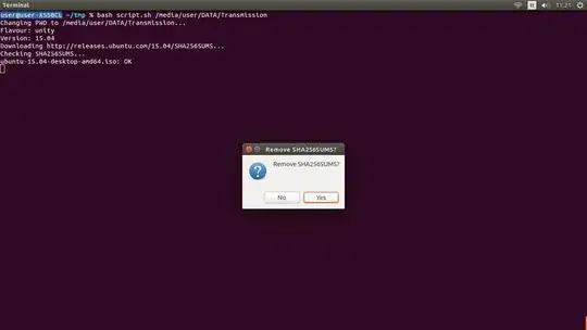

Example on an Ubuntu Desktop 15.04 64-bit image:
screenshot1
screenshot2
screenshot3
screenshot4
