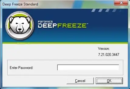

Is there any application in Ubuntu that can do exactly what Windows DeepFreeze does? (for example: you are working fine but when you restart the PC it always goes back to the time when you applied deepfreeze)
Example:
When you want to un-deepfreeze you apply password, so that it can be used by anyone but only Admin can un-deepfreeze to upgrade. enter image description here
Once you logged in you can then tell is it frozen mode or upgrade mode:
How can i do this in Ubuntu please?
