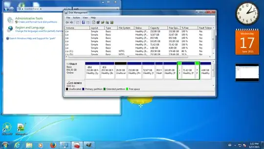

In relation to the stuff of resizing a Windows partition (Control Panel -> Search by 'partition' word -> Create and format hard disk partitions) inside Windows (except in XP) to free space for Ubuntu, I used my own system. In the next image:
I shrunk (the menu appears with right buttom of mouse) the second NTFS partition (C, with Windows 7) in 30 GB. The process it took only a few seconds. The result can be observed at the next image (free space with the black label):
Afterward, I reverted this process in about a second by using the tool for extending the C partition. Nothing bad happened. I am posting from Windows 7.

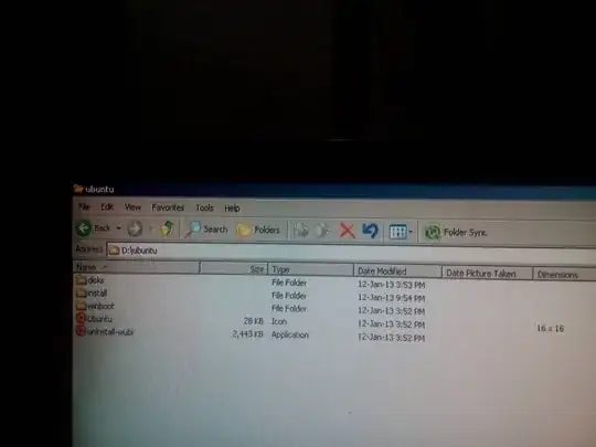

I don't know how everyone missed the most simple option. Run Ubuntu inside Windows, with the exception of it being able to boot.
It's the WUBI option. Detailed guide is available here -
https://help.ubuntu.com/community/Wubi
The original partitions or the Windows installation is not disturbed at all. Ubuntu installs in a folder and updates boot options to allow booting either Windows or Ubuntu.
I have done it on a desktop as well as a laptop, both of which had Windows pre-installed.
A very old desktop with Windows XP, and Ubuntu in a folder on the D partition
