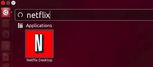

Install Netflix desktop app in Ubuntu 14.04
sudo apt-get install netflix-desktop
