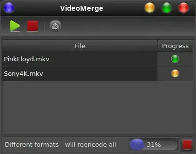

I'd like to throw in my "videomerge" - available for ubuntu via ppa:
Its a QT5 GUI app using drag'n drop. To install:
sudo add-apt-repository ppa:jentiger-moratai/mediatools
sudo apt update
sudo apt install videomerge
As all of my apps, I try to keep the UI very simple:
