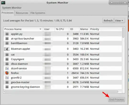

Using GUI, you can use System Monitor

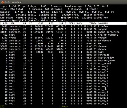

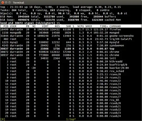

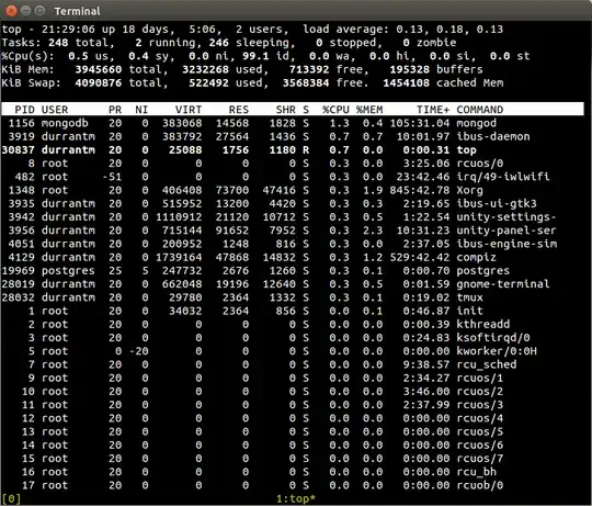

My main tool here is top
type top at the command line in a terminal window
You'll get a list of the process that are running, listed by cpu usage. Wait a few seconds for it to gather more stats before proceeding.
This is my main tool in unix for killing runaway or unwanted processes. They are likely to be near the top of the list. Note their pid and press q and then either 15 (soft kill) or 9 (hard kill).
Here you see me killing a Chrome process:
The process should go away. Then type q to quit out of top.

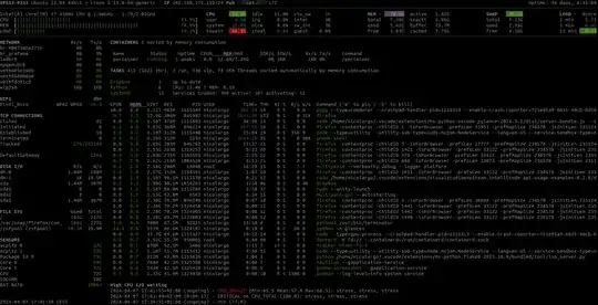

Another good tool to use will be Glances.
Glances screenshot
