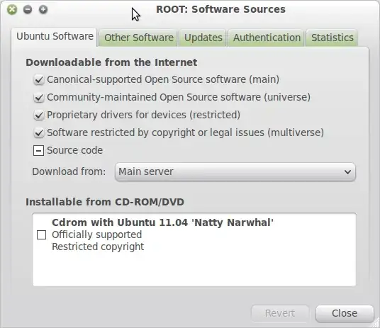

I would recommend you top enable multiverse repository in software sources:
enter image description here and then install the package ubuntu-restricted-extras and ubuntu-restricted-addon which will install most of the restricted codecs, flashplugin, unrar, microsoft fonts etc. If you need more restricted codecs you may install medibuntu repository as well. You may try mplayer vlcas well for multimedia. Other than that there are lists of download manager although I personally prefer DownThemAll of Firefox. As for tuneups and cleaning utility I would like to add ailurus to the mix.
