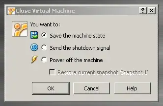

The appropriate way to save a virtual machines state (and resume later) is to coose Save the machine state when closing the machine from virtual box manager (here depicted for Windows XP).
This will free all ressources from the virtual machine. Next time we start the machine we will resume exactly at the same state where we saved it (like in suspend/hibernate from a real machine).
From command line this can also be done by
VBoxManage controlvm <name_of_machine>  savestate
Note on security: Mind that resuming from a saved state does not ask for authentication for the guest OS. In case we work with confidential data we therefore need to log out (or switch user) from the guest OS before saving.
