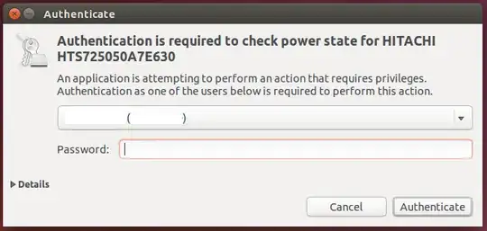

One of the users on my system (Ubuntu 14.04) has an encrypted home directory... after I log out of the encrypted user and log into another unencrypted user, I am getting a series of window asking me to authenticate myself. I did not use to see them before I created the encrypted user, and when I nevertheless enter the password, it keeps asking me to enter the password or about 10 more times until it eventually stops....

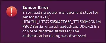

If I click on the "Cancel" button, I see the following error message:
What can I do to stop the authentication requirements when I log in?

Had the same problem today (28th Sep 2015) after an update. I was to lazy thou to solve the problem, I just disabled the udisks2 plugin in hardware sensor indicator. It seemed to be the source of the annoying authorization requests.
Cheers, Stwur
Stwur
  • 41
I highly doubt that the encrypted home directory is the culprit since I am also greeted by these happy little password boxes any time I switch TTY's or VT's without having any encryption on my home directory. If I cancel them, nothing really happens except the indicator-sensors package becomes a stale application with sensor readings from before I cancelled the pop-ups.
Do you by any chance have the package indicator-sensors installed on your system? You can verify it is, or is not, by typing dpkg -s indicator-sensors in a terminal window.
A possible workaround for this problem is to add the user to a group that has the rights to read the power state. - I have yet to figure out which group this is though, and if it's even advisable.
Edit:
I have tracked down the issue to the udisks2 package. A quick search led me to this forum. I do not advise to pull this guy/gal's trick on your own machine though. There has to be a cleaner way.

After fiddling around a little, I think I found the solution. You indeed need to create a new group that has authority to mount and read disks. This is done like so:
cd /usr/share/polkit-1/actions/ #this is where your policies are stored
ls -la | grep org.freedesktop #find the correct policy. Should be udisks2.policy
<your-text-editor-here> <policy-file>
Now you can edit the policy file accordingly. Since I did not have the exact same problem, I cannot post my fix. But here's what I found while applying my fix:
<action id="org.freedesktop.udisks2.ata-check-power">
    <description>Check power state</description>
    <message>Authentication is required to check the power state</message>
    <defaults>
        <allow_any>auth_admin</allow_any>
        <allow_inactive>auth_admin</allow_inactive>
        <allow_active>yes</allow_active>
    </defaults>
</action>
Based on your problem description I would suggest fiddling with this section until the pop-ups stop showing up.
