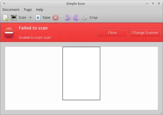

I use Canon CanoScan LiDE 25 and recently tried to scan again using Simple Scan. While the scanner always works for 32-bit system, it had failed work at all for 64-bit system. I have confirmed these results while running Xubuntu 14.04.
Proof of failed attempts
In the following attempts, I connect the scanner to USB 3.0 and 2.0 ports in turns and run lsusb and dmesg | tail commands in Terminal to confirm it is being detected. The output lines have been trimmed to show the relevant ones only.

Why did not work
I read somewhere that the presence of USB 3.0/XHCI may interfere the use of scanner. This didn't make much sense to me, so I just tried changing the ports without disabling any USB settings in BIOS/UEFI menu. In both attempts, Simple Scan failed with error as shown in screenshot below.
Simple Scan failed with error in Xubuntu 14.04 64-bit
I estimate 64-bit driver support is still lacking to this answered date. Or, 32-bit device driver must be used to make the scanner work properly. That being said, I even tried to install Simple Scan for 32-bit system on Xubuntu 14.04 64-bit system but failed miserably.
Now it works (2016-07-06)
I tested again Canon CanoScan LiDE 25 against Xubuntu 16.04 64-bit live system. I repeated the attempts above and it worked from both USB 2.0 and USB 3.0 ports. No further configuration is required; the scanner works out of box in 16.04 releases.
Above all, I didn't manage to figure out why it didn't work in 14.04 64-bit and why now it works for 16.04 64-bit. These LTS releases are already quite different in terms of kernel release, package version, program version, and others.
TL;DR For 64-bit system, the easiest solution is to use the current release (16.04). Else, the scanner works in 32-bit system of any release that is supported to this date.
