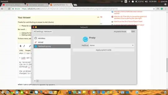

when I use this command to update my system.
sudo apt-get update
my terminal gets stuck with this statement showing
[Connecting to 10.10.3.254 (10.10.3.254)]
and nothing happens afterwards, I had to cancel the task. although I can access the internet with the browser.
The problem was due to proxy and I had applied the proxy earlier but later changed to none, but these steps do not configure the network, system wise
here in this situation set your proxy to none and apply changes system wide, and after that, your terminal works fine. I had the similar issue but i figured it out as I mentioned
