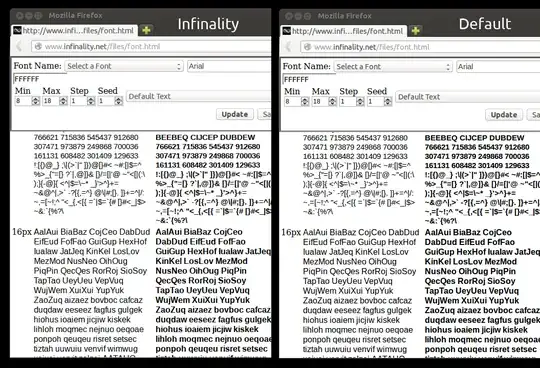

I would suggest this article on WEB UPD8: Better Font Rendering In Linux With Infinality
Infinality is a set of Freetype patches that try to provide an improved font rendering for Linux and also, to allow easy customization so the users can adjust the settings to their taste. Using it, you can easily set the font style to emulate OSX, OSX2, Windows 98, WIndows XP or Windows 7 or you can use the "Linux" or "Infinality" (default) styles.
This is just an example (left the "Linux" style, right the default Ubuntu config).
Freetype with the Infinality patches can be installed in Ubuntu by using a PPA. To add the PPA and install the required packages in Ubuntu 12.04, 14.04, 14.10 or 15.04 use the following commands:
