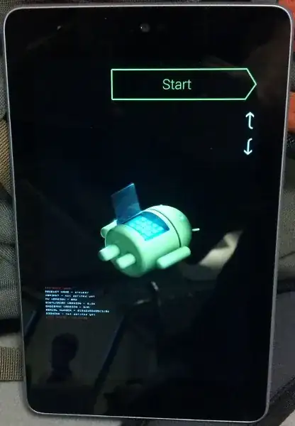

  1. Reboot your 2012 Nexus 7 into the Android boot loader. To do this, first power down the device in the normal fashion (hold down the power button, then select power off and wait a few seconds). From the off state, hold the volume down button and press the power button. Continue holding the volume down and power buttons until you see the boot loader UI.
  2. Using a micro-USB cable (the one you use for charging should be fine), plug your device into any computer running Ubuntu. The device now displays the boot loader GUI, which looks like this:
This is the bootloader.

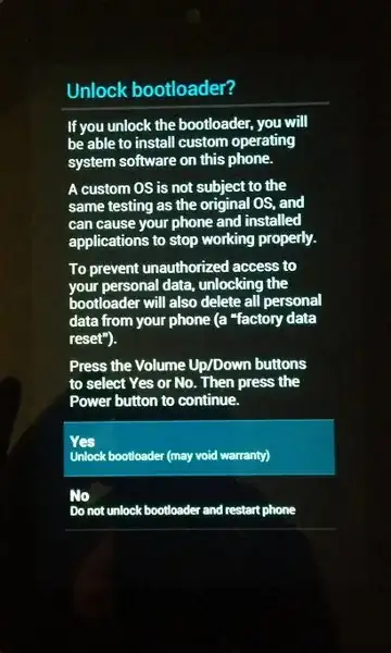

  3. Your device should now prompt you to unlock the bootloader. Follow the on-screen directions to continue. Your screen should now look like this:
This is the prompt.
