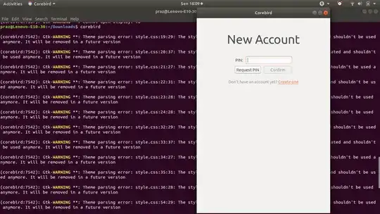

I tried your corebird index
praz@Lenovo-E10-30:~/Downloads$ sudo gdebi corebird_1.0-1_amd64.deb
Reading package lists... Done
Building dependency tree
Modern, easy and fun Twitter client Twitter client, built using GTK+. Do you want to install the software package? [y/N]:y Selecting previously unselected package corebird. (Reading database ... 273217 files and directories currently installed.) Preparing to unpack corebird_1.0-1_amd64.deb ... Unpacking corebird (1.0-1) ... Setting up corebird (1.0-1) ... Processing triggers for menu (2.1.47ubuntu1.17.10.1) ... Processing triggers for bamfdaemon (0.5.3+17.10.20170810-0ubuntu1) ... Rebuilding /usr/share/applications/bamf-2.index... Processing triggers for desktop-file-utils (0.23-1ubuntu3.17.10.1) ... Processing triggers for gnome-menus (3.13.3-6ubuntu5) ... Processing triggers for mime-support (3.60ubuntu1) ... Processing triggers for hicolor-icon-theme (0.17-1) ... Processing triggers for libglib2.0-0:i386 (2.54.1-1ubuntu1) ... Processing triggers for libglib2.0-0:amd64 (2.54.1-1ubuntu1) ... Processing triggers for man-db (2.7.6.1-2) ...
after installed I can open it
my corebird have been opened
I think try use gdebi, I hope this helps.
