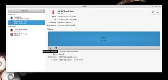

Launch the app gnome-disk-utility, find your usb on the sidebar, and click the triangle play button under the filesystem graph and it should mount it.
Like this: mountusb:
