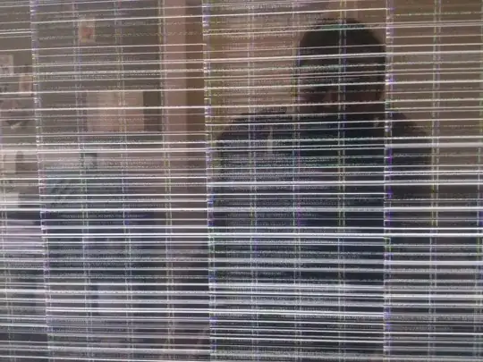

Also, if I reboot instead of shutdown, I get this psychedelic lightshow on my monitor and have to long-click the power button to turn it off:
reboot fun
