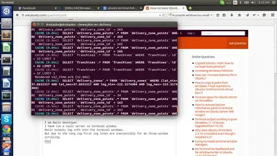

I am Ruby on Rails developer. I have run a Ruby on Rails server in the terminal window. Ruby on Rails outputs log information into the terminal windows. But due to the long log, the first log lines are inaccessible for me through window scrolling.
How could I increase the number of lines shown in the terminal window?
Enter image description here

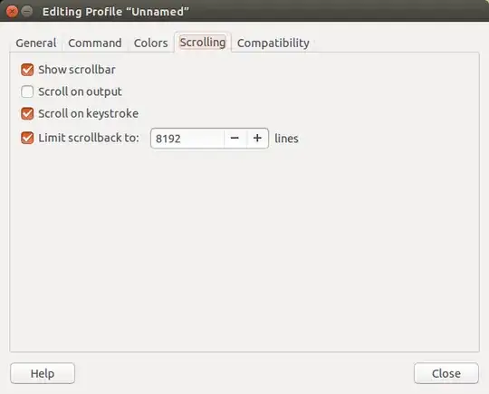

Click EditProfilesScrolling. Then increase the value under limit scrollback to: or untick it to allow scrolling through unlimited lines.
Terminal Preferences
From comment by Kevin: Be careful with unchecking that option. If a program goes crazy and spews lots of data onto your terminal, you could have memory issues.

Open the profile settings for the terminal via
Edit > Profile Settings.
Or with a right click in the terminal:
Profile > Profile Settings
Change the value for Limit scrollback or remove the mark for unlimited scrolling.
